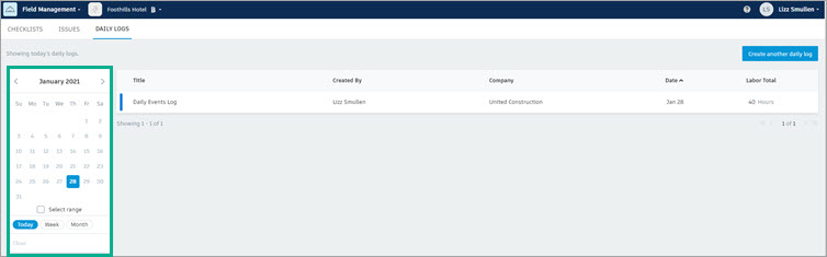

Controlling the Daily Log List View
You can use the calendar to filter the list of daily logs available to select in the list.
You can control the following:
- Change the month using the arrow icons (useful at the beginning or end of a month)
- Select a specific day in the calendar
- Check the select range checkbox and select a beginning and end day
- Select Today to see the daily logs of the day
- Select Week to see the daily logs from the week containing a selected day
- Select Month to see the daily logs of the month showing
