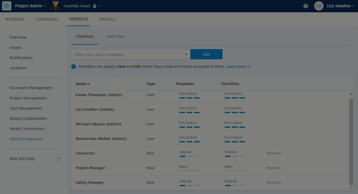

Project administrators can modify the permissions for specific members, roles, or companies for field management. To modify permissions:
- Go to the Project Admin module.
- Click the Services tab.
- Select Field Management in the panel on the left.
- Select the Checklists or Daily Logs tab to modify permissions.

Template Permissions
Template permissions are controlled on the checklists tab. Use the drop-down to select the desired permission set for each member, role, or company.

Checklist Permissions
Checklist permissions are controlled on the checklists tab. Use the drop-down menu to select the desired permission set for each member, role, or company.
