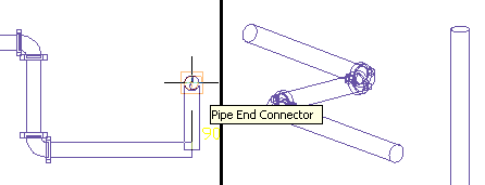

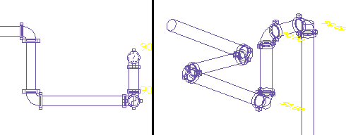

Consider a scenario where you are working in the top view. You attempt to connect a horizontal run to a riser. You configure 2 viewports in the drawing window. The top view is used in the left pane and an isometric view to the right to preview routing solutions. In the top view, only the pipe end connector is available on the riser.
If you select the pipe end connector, routing solutions are offered that do not connect the horizontal run to the riser at the correct elevation.
