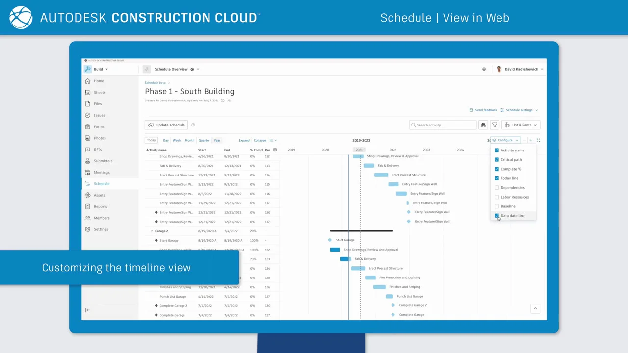

To import a schedule:
- Click Schedule from the left navigation to open the Schedule tool.
- Click Import schedule.
- Browse for a file to import.
It may take a few moments for the schedule to upload and be processed. You'll receive an email notification when the schedule is ready to view. When the schedule is ready to view, it will display in the Gantt view within the Schedule tool.
The imported schedule is displayed in the Schedule tool, while the imported file itself is stored in the Files tool. A dedicated Schedule tool files folder is automatically created within the Project Files folder, and the folder name is based on the name of the imported file. Moving or renaming the folder does not affect the connection between the Schedule tool and the stored file.
Permissions for the sub-folder in Files where the schedule is stored are kept in sync with the schedule permissions. This means that users who do not have sufficient permissions to access the schedule in the Schedule tool will also be unable to download the source file from the Files tool.
