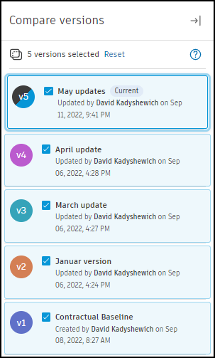

  1. Click the Compare button in the Version history pane.
  2. Select versions to compare.
Important: You can select up to 5 versions to compare.
Version history

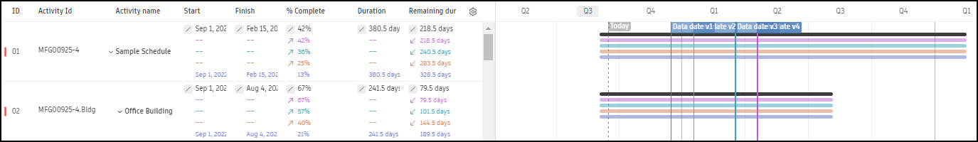

Differences between schedule versions are color-coded and visible in List and Gantt views. Filtering, searching, and grouping, as well as Configurable Gantt view elements like dependencies, critical path, or resources are displayed only for the selected version.
In the Compare view, there are two additional columns in the table:
  • Start variance
  • Finish variance
These columns highlight the differences in start and finish dates between the compared versions.
Note:
Searching and filtering in Compare mode only show matching activities without parent tasks to highlight the changes, while View mode shows matching activities with parent tasks.
Gantt and List
Important: Each version is compared to its predecessor. Other comparison modes will be available in the future.
