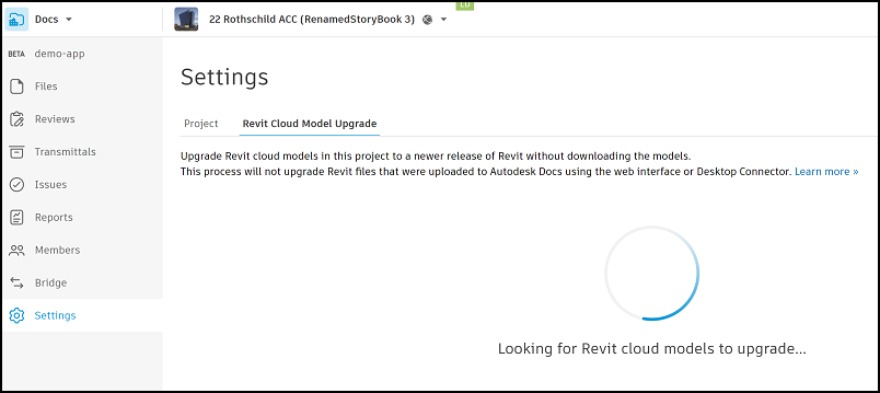

Upgrade Revit Cloud Models
  1. Select Docs from the product picker.
  2. Select the Settings tool on the left panel.
  3. Select the Revit Cloud Model Upgrade tab.
    A check begins immediately to determine if you have models available to upgrade.
  4. If you see the message Upgrade recommended, click Upgrade.
