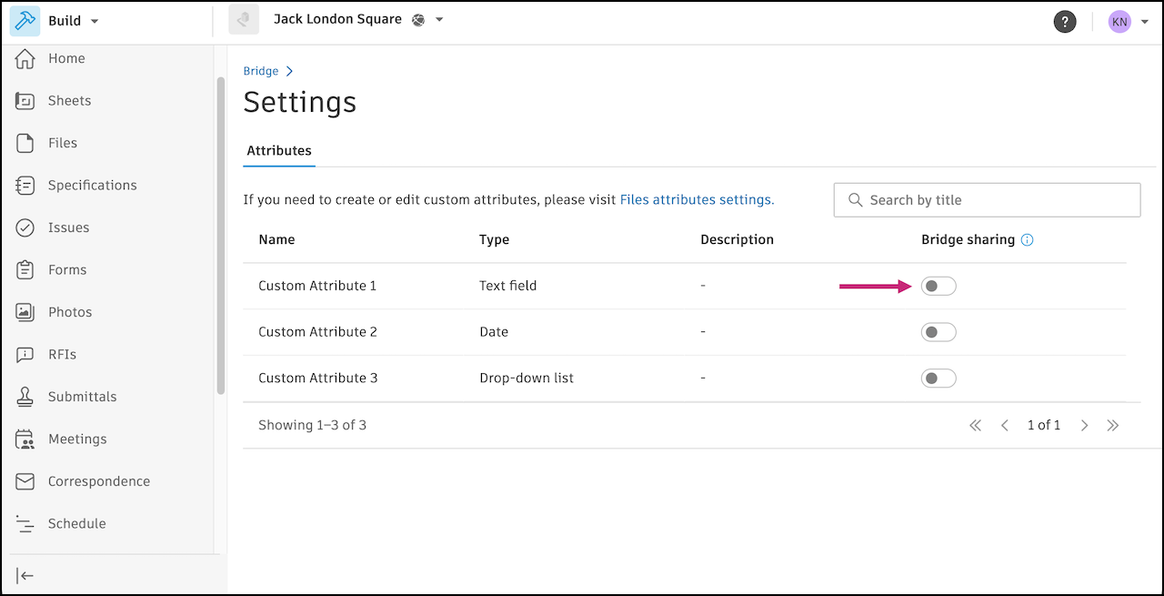

Select File Attributes to Share
Project administrators can select which custom file attributes to share when files are shared through Bridge.
  1. Open the Bridge tool using the left navigation menu.
  2. Click Settings button.
  3. In the Bridge sharing column, toggle on the file attributes you want to share when files are shared.
    Note: The list of attributes comes from the Files tool. To create or edit file attributes, click the File attributes settings link in the header to open the Attributes settings in the Files tool. Learn more about file attributes and how to create them.
    Toggle on bridge sharing
