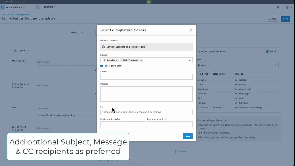

E-Signature Adapter – Using a common setup and workflow, Cost Management now supports direct integrations with multiple customer-preferred e-signature tools: DocuSign, SignNow, and Adobe Sign. A Dropbox Sign integration is currently in development.
  • A subscription with one of the supported vendors is required.
  • Administrators set the e-signature vendor in the Account Library. There, they also define default signers and roles, set signer order, optional default subject line/message, and set reminders and expiration days.
  • Project level signers and settings can be configured within project settings too if required.
  • Once set up, when a member generates a document package, they can easily trigger the e-signature process. The status changes to Sent.
  • Signers receive email notifications. Once the process is complete, signed documents are uploaded back into Cost Management, and the status changes to Executed.
  • Ball in court is tracked in the workflow steps bar in the flyout.
