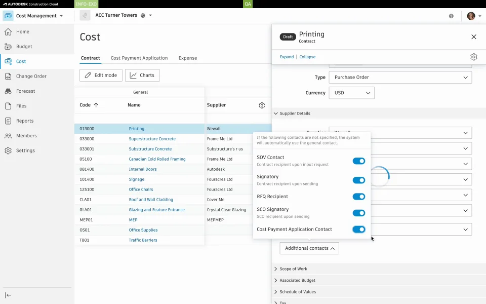

Edit Contract in the Flyout Panel
To edit extra information pertaining to a specific contract, select the contract name to open the details flyout panel. Key items:
  • Budget Code – Provides a list of all unallocated budget items. Create the connection between contract and budget item by assigning from this list. Learn more about Budget Codes.
  • Supplier Details – extra contacts option allows members to specify contacts for the following:
    • SOV Contact: contract recipient upon input request.
    • Signatory: contract recipient upon sending.
    • RFQ Recipients.
    • SCO Signatory: SCO recipient upon sending.
    • Cost Payment Application Contact.
    Note: If the above contacts are not specified, the system will automatically use the general contact.

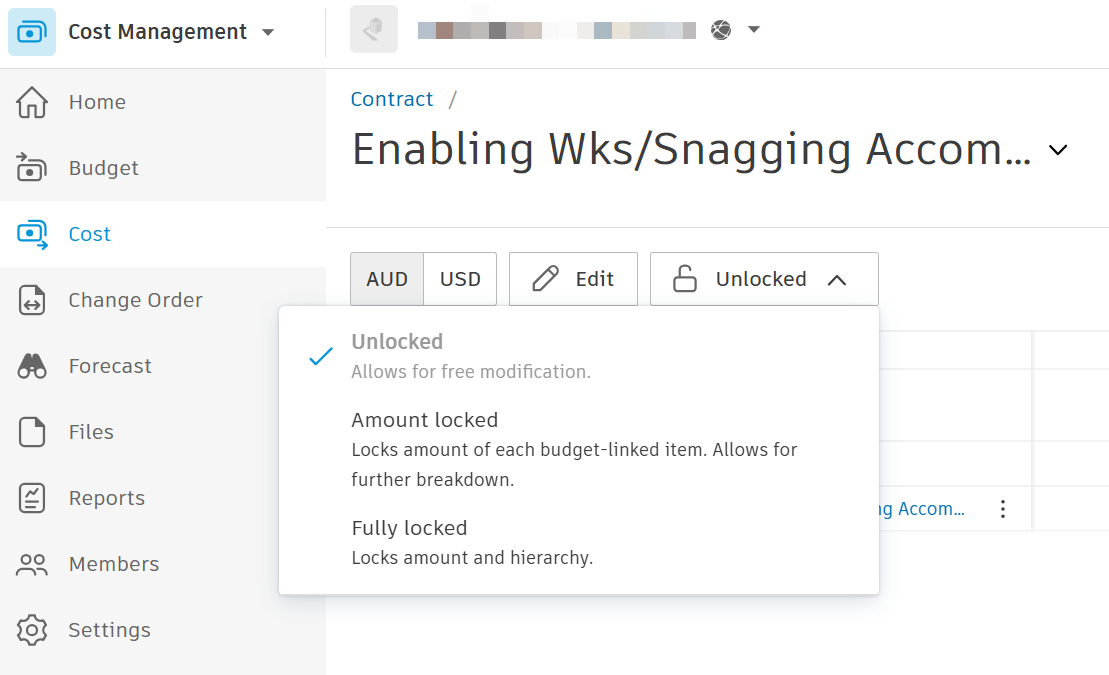

Lock and Unlock Contract SOV
You can lock the Schedule of Values, which will disable modifications of both the amount and the hierarchy. Alternatively, you can choose to lock only the amount.
Lock and unlock contract
Tip: After selecting the option to lock only the amount, it will still be possible to edit fields such as Code, Name, and Qty. You can also edit the hierarchy. This allows the general contractor or supplier to break down budget-linked SOV items before a cost payment application is created.
Note: Even when the contract is in the Executed status and the amount is locked, users with collaborative access can still add or import SOV subitems. See Manage the SOV Hierarchy for more information.

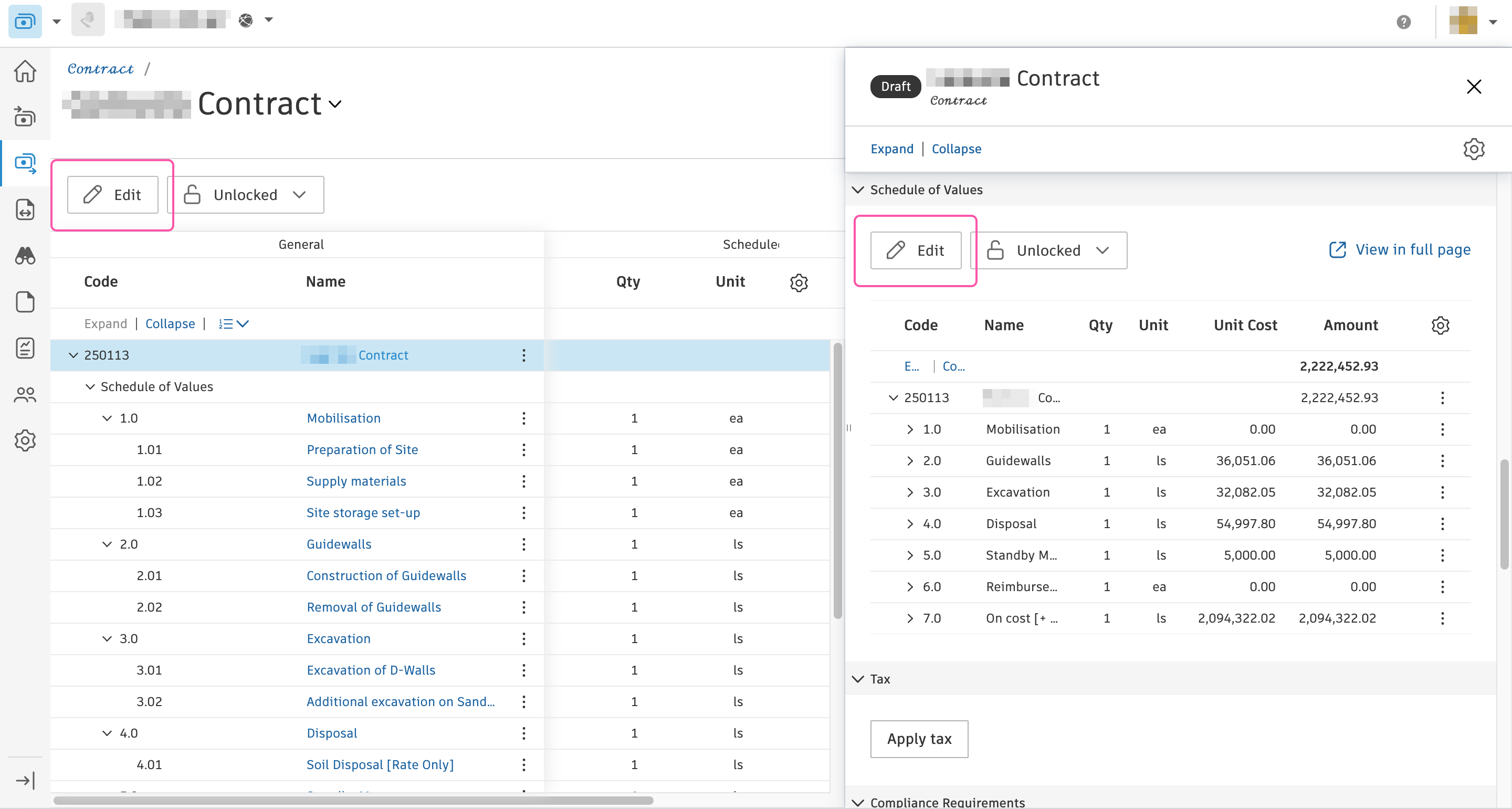

Edit Contract Schedule of Values
Edit Contract Schedule of Values brings all editing actions into one consolidated interface. It provides enhanced flexibility for managing the hierarchy and assigning budgets at any level.
There are two ways to access the contract SOV edit modal:
  • From the contract details page, click Edit.
  • From the contract flyout panel, in the Schedule of Values section, click Edit.
Edit contract SOV button

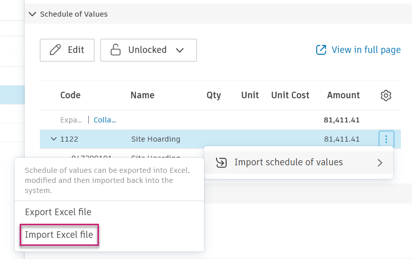

Import and Export Contract SOV
You can import and export contract SOVs using an Excel spreadsheet to reduce manual effort when managing large numbers of SOV items.
There are two ways to access the Import subitems option in Cost Management:
  1. From the contract details page:
    • Click Edit.
    • Within the Edit Contract Schedule of Values modal, click the More menu More menu icon next to an item and choose Import subitems.
  2. From the contract flyout panel:
    • In the Schedule of Values section, click the More menu More menu icon and choose Import schedule of values.
To import SOV items, click Import Excel file to upload a previously created file containing SOV details. You can also download SOV template, fill it with data, and then import.
Import Excel file
To export SOV items:
  1. Click Export Excel file to download the current SOV structure as an Excel file.
  2. Modify the exported file as needed and reimport it into the system.
Notes and Limitations:
  • The import function does not support the deletion of existing SOVs. However, you can modify fields such as SOV number, name, quantity, unit cost, and amount.
  • If new subitems are added to the spreadsheet, they will be included in the import.
  • After creating cost payment applications, you can revert Full Locked SOVs to an Unlocked status. This allows you to export all tree structures, update the Schedule of Rate (SOR), and reimport them.
  • For spreadsheet imports, SOV items or subitems cannot be added or deleted if a payment application exists. However, fields such as SOV number, name, quantity, unit cost, and amount can still be modified.
  • For manual operations on the web page, you can delete SOV subitems if there is no Work Completed Amount or Material Stored Amount in the cost payment application.
