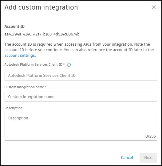

  1. Click Add custom integration in the Custom integrations tool.
  2. Provide your APS Client ID. The Client ID is the unique identifier for your custom integration. You can find the Client ID in the APS portal.
  3. Provide your integration name.
  4. Provide an integration description.
  5. Click Next.
  1. Previously configured Secure Service Accounts (SSAs) for your Client ID will automatically be retrieved.
    • If no SSAs are found, there will be no way to control the permissions for this integration and it will act as an Account Administrator with immediate access to all data within your account. Click Proceed anyway to complete the integration.
    • If a single SSA is detected, the integration is automatically attached to this SSA. No data access is granted to the integration until the SSA account has been invited to a project. Click Got it to complete the integration.
    • If multiple SSAs are detected, provide the email address of the SSA you wish to attach to this integration. Click Add to complete the integration.

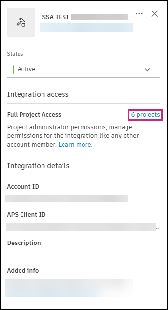

Selecting a custom integration from the list in the Custom integrations tool will show details about the integration, including its access level. The highest level of access that the integration has across all projects is shown here. For example, if the integration has full access to one of your projects, but restricted access to another project, the integration access will still be "Full Project Access".
To view details on the access level of an integration on a per project basis:
  1. Select the integration from the integration list in the Custom integrations tool.
  2. Under "Integration access", Click the number of projects link.
Integration access
There are three possible access levels, each meaning the following:
  • Full Account Access: No associated SSA, so the integration has Account Administrator access to all data in your account. Since no SSA exists, the integration will use two-legged authentication.
  • Full Project Access: The SSA attached to the integration is a Project Administrator to at least one project.
  • Project Access: The SSA attached to the integration is a Project Member to all projects it has been invited to.
