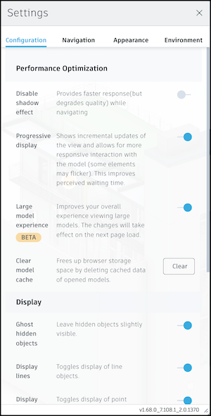

3D Models
Configuration (3D)
Performance optimization (3D)
Disable shadow effect: Provides a faster response, but degrades quality while navigating.
Progressive display: Uses incremental updates of the view for a more responsive interaction with the model.
Large model experience (BETA): This feature is part of an open beta that when turned on, improves your overall experience viewing large models.
Display (3D)
Ghost hidden objects: Leaves hidden objects slightly visible
Display lines: Toggles display of the line objects.
Display points: Toggles display of point objects.
Display edges: Shows outline of model surfaces.
Display section hatches: Shows hatch pattern for sections planes. This does not apply to section boxes.
Display units: By default, the file will show the units used in the uploaded file. You can choose to display in one of the different units of measurement in the drop-down menu.
Precision: By default, the file will use the precision from the uploaded file. You can choose a specific precision value from the drop-down menu.
