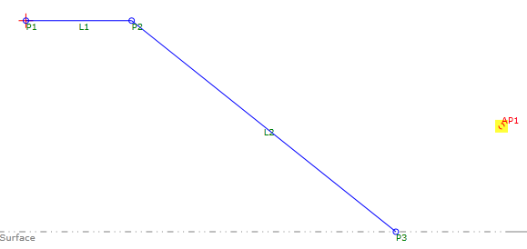

Example
To see an example of how this geometry element is used, open the following Sample PKT file:
Auxiliary Mark Point Example.pkt
In the example,
AP1 is the auxiliary mark point. The Delta X and Delta Y values are both 0.5 from P3, which slopes from P2 to the target surface. As the surface elevation changes, P4 maintains its position relative to P3.
