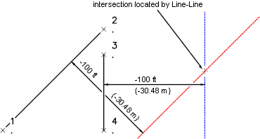

You can find the point of intersection between two lines defined from existing points. After an intersection is found, you can save it by specifying a new point number.

LNLN 1 2 100 3 4 -100
! INTERSECTION # 1 NORTH:158.578644 EAST:300.000000
An intersection is located between a line drawn between points 1 and 2 with an offset of 100 feet to the right and a line drawn between points 3 and 4 with an offset of 100 feet to the left.
