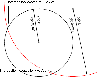

You can calculate the intersection(s) of two arcs, each defined by an existing center point and a radius.

! INTERSECTION # 1 NORTH:8.856217 EAST:141.143783
! INTERSECTION # 2 NORTH:141.143783 EAST:8.856217
Intersections are located between an arc radius of 100 with a center at Point 1 and an arc radius of 200 with its center at Point 2.
