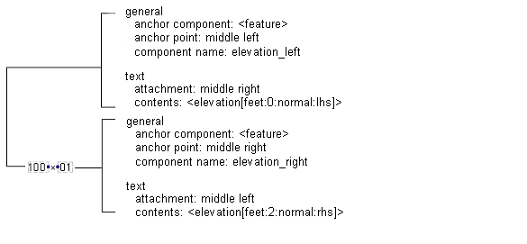

The spot elevation label style is configured in the Label Style Composer. When a spot elevation is created, the command can specify an existing point style and label style at create-time, or a block can be specified in the composition of the spot elevation label style.

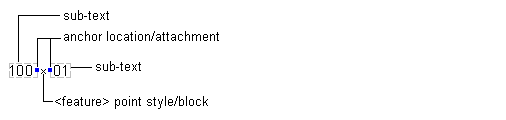

The following examples illustrate a label style that can label a spot elevation at the elevation decimal point. The decimal point of the spot elevation value is represented by a block, or a point style specified at creation time. The labeled elevation consists of two subtext components in the label style, each with different properties:
