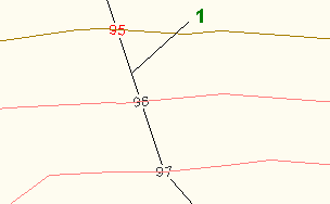

Multiple Contour Labels
Use a line or polyline of an existing object as a label line or draw a label line (1) that crosses multiple contours.

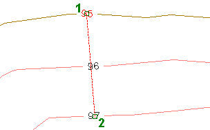

Multiple Contour Labels at an Interval
Create multiple contour labels at an interval by drawing a contour label line (1) that crosses surfaces contours and specify the interval (2) between the labels along those contours.

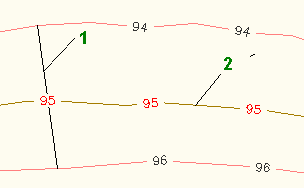

Single Contour Labels
Use a line or polyline of an existing object as a label line or draw label lines on the fly for single or multiple contours.
