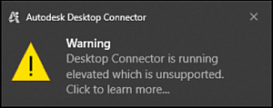

Desktop Connector does not support running elevated due to Microsoft security reasons. Running elevated may result in an error when attempting to browse, open, or save files stored in Desktop Connector. The following warning will be displayed to inform you that you are running elevated.
If a user performs a right-click Run as Administrator action on Desktop Connector.
If group policies are configured in a way to run products elevated.
Desktop Connector does not support interacting with other programs which are running elevated.
For additional information refer to Desktop Connector is running elevated which is unsupported.
