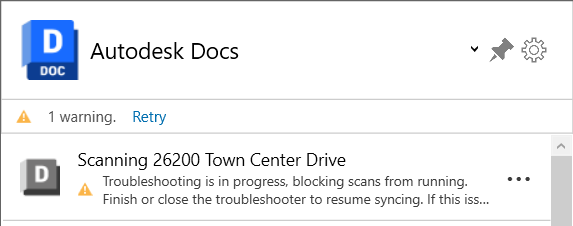

Scan Job - Warning
You may see a warning message on a scan job when other activities are interfering with the scanning process:
Scanning warning notification
  • "Another system activity is blocking the scan..." - Desktop Connector is syncing changes from the cloud to your local workspace. The scan will automatically continue once this sync completes.
  • "Troubleshooting is in progress" - Desktop Connector is actively troubleshooting an issue. The scan will resume when troubleshooting is complete.
  • "Activity detected. Scanning will continue once user activity has paused." - You're actively working in files. The scan will automatically resume when you pause your work.

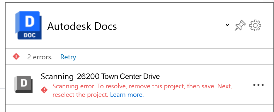

Scan Job - Error
Scanning error notification
In rare cases, a scan job may fail. If this occurs, try removing and re-adding the project from Desktop Connector. This typically resolves scan errors caused by duplicate file records or other project-level conflicts.
