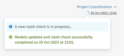

| The files are still processing in Forma Data Management | Before Model Coordination can start a new clash check, the files must finish processing in Forma Data Management. If you've uploaded new files and a clash check hasn't started after a few minutes, check the files in Forma Data Management. | If the files have failed to upload or process in Forma Data Management, you can retry the processing or you may need to upload the files again. |
| The clash check on your latest models is still processing | Clash checks can take from between a few minutes to a few hours, depending on the coordination space version you are using and the amount of model content being checked for clashes. ![]() |

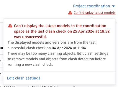

| The latest clash check was unsuccessful | ![]() |
See the Clash FAQ topic to learn more about unsuccessful clash checks and how to address them. |

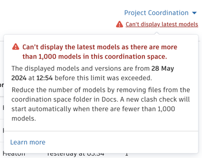

| You've reached the limit of 1000 models* in a coordination space | Clash checks can't run when there are more than 1000 models* in the coordination space. This applies to all models, including those not supported for clash and those that are turned off for clash. When there are more than 1000 models, Model Coordination will display the same models as before the limit was exceeded. If there were more than 1000 models before the coordination space was created, no models are displayed. ![]() |
Reduce the number of models in the coordination space by deleting or moving files out of the coordination space folder in Forma Data Management, or creating multiple coordination spaces with fewer models in each. For example, create a coordination space for each building in a project, or for each level of a building, or phase of a project. You can also change the coordination space settings to include fewer subfolders. A new clash check will trigger automatically when there are fewer than 1000 models in the coordination space. |
* Note: Each 3D view in a Revit file is considered as one model in Model Coordination. There may be more than 1000 models in a coordination space even though there are fewer than 1000 files in the coordination space folder in Forma Data Management.

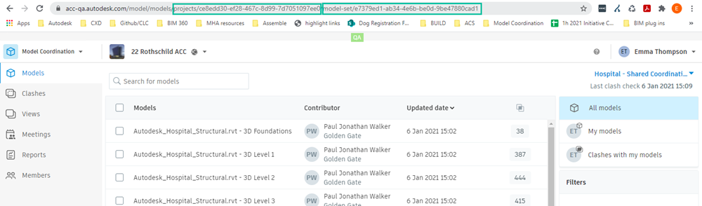

How do I find my project and model-set IDs?
When you open Model Coordination and select a coordination space, your project and model-set IDs are shown in the page URL:
Provide the whole URL when reporting problems using the online Contact Support form to give our team a starting point for investigation.
