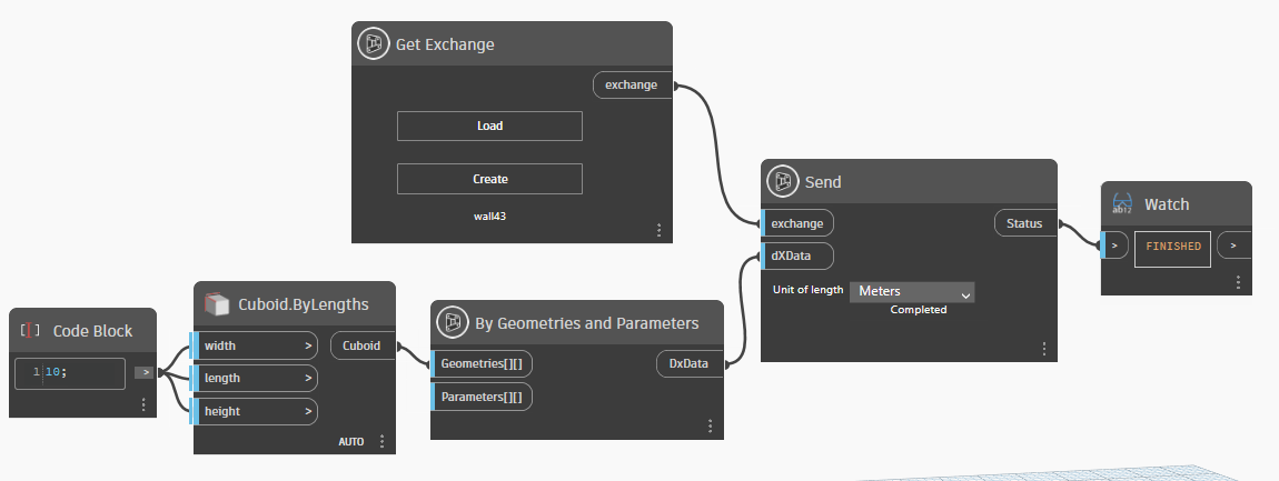

The following procedure demonstrates how you can create a Data Exchange after reading it from Autodesk Docs and viewing the Status of whether it is created in the output.
  1. Connect the Exchange input port of the Send node with the output of the Get Exchange node and the DXData input port with the output of the ByGeometryParameters node.
  2. Connect the output of the Send node to the input of the Watch node to view the Status of whether the Data Exchange is created.
