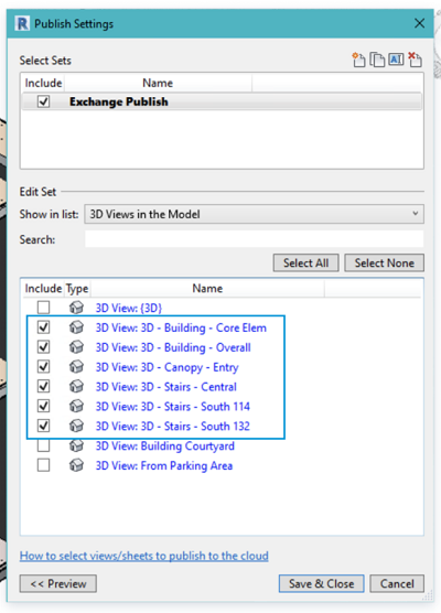

Add 3D Views to a Publish Set
Add the 3D views that you want for your Data Exchange to a Publish Set. You can create a new Publish Set, or include these views in an existing Publish Set.
Learn more in Create a Set and Select Views to Publish in Revit.
