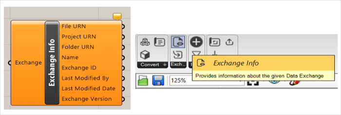

Exchange Info
This node is useful to view the Data Exchange information. This node takes Data Exchange as input and provides specific information about the Data Exchange in the Panel through separate outputs.
| Supported Input Type | Expected Output |
| Data Exchange as an object | Data Exchange information as an object |
| Name of the Data Exchange | |
| File URN (Uniform Resource Name) | |
| Folder URN | |
| Project URN | |
| ID Of Data Exchange (Exchange ID) | |
| Last Updated Date | |
| Last Updated By | |
| Exchange Version |
Click and drag the ExchangeInfo node from the toolbar to canvas.

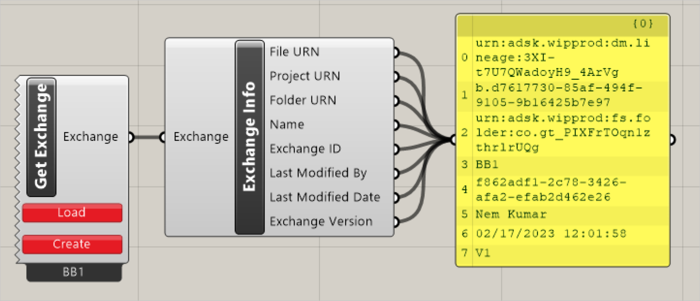

Connect the GetExchange node output to the input of the ExchangeInfo node.
Connect all the individual outputs of the ExchangeInfo node to the Panel to view the Data Exchange information.
