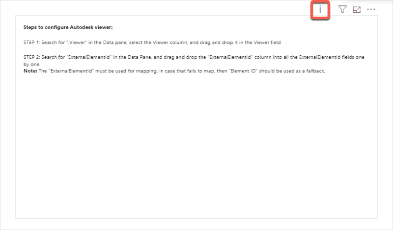

My Power BI visual is not displaying any data. What could be the issue?
Make sure that all required columns from your dataset are assigned to the appropriate fields within the visual.

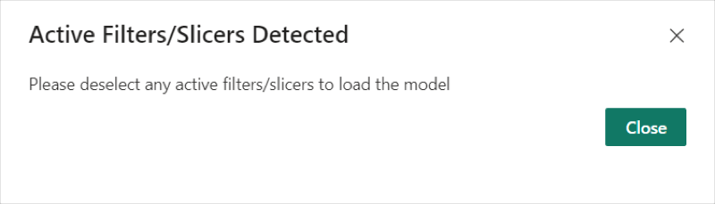

Why is the Power BI visual not loading the model, even though I have filled out all the required fields?"
Active slicers or filters can sometimes impact the loading. Check for such active filters as shown in the following images and disable them.

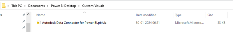

Why is the Connector and Visual files are not visible at their respective locations after installation?
Typically, the Connector(.pqx) and Visual(.pbiviz) files are installed in your user directory in the following paths:
- .pqx C:\Users<UserName>\Documents\Power BI Desktop\Custom Connectors
- .pbiviz C:\Users<UserName>\Documents\Power BI Desktop\Custom Visuals
For best results, log in to your computer as the user who will be using the Power BI connector before installing. This ensures the connector is installed in the correct location for that user. The installer might ask for administrator privileges during the process. Only provide them if prompted. If you run the installer as an administrator for a user without admin rights, the connector will be installed in the administrator's documents folder, not the intended user's folder.
