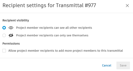

  3. Click Recipient settings.
    Recipient settings dialog
    You can:
    • Set whether project member recipients can see all other recipients or only themselves.
    • Allow project member recipients to add more project members to this transmittal
      Note: When members create a transmittal, they can also let project member recipients add more project members to that transmittal.
  4. Make your selections.
  5. Click Save to update the settings for all selected transmittals.

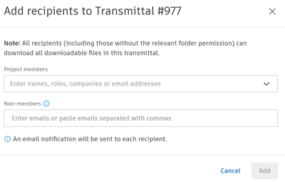

  2. Click Add recipients.
    Note: You can also open an individual transmittal and click Add recipients in the RECIPIENTS panel.
    This option is not available if you don’t have permission for a selected transmittal, or if the transmittal has reached the recipient limit.
  3. Add project members by selecting users, roles, or companies.
    If you are a project administrator or the sender, and the project has enabled Transmit files to anyone, you can also add non-members by entering their email addresses.
    Add recipients dialog
  4. Click Add to add the recipients.
    Recipients get an email notification when you add them.
