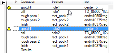

The automatic ordering of operations determined the order by a set of rules. You can also specify an exact ordering of operations manually.
  1. Select the Manual Ordering option on the Op List tab.
  2. In the Fixed Operation Ordering dialog, select Do Not Show This Warning Again, and click OK.
  3. Select the spotdrill operation for hole2 from the list, and drag it up ahead of the drill operation for hole1.
  4. Simulate the part.
