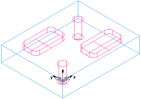

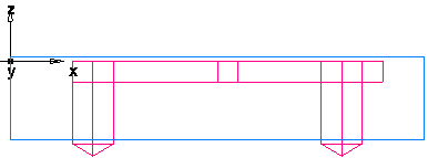

To look at the part in a different orientation you can select one of the standard predefined views.
  1. To change the view to a front view, click View tab > Views panel > From > Front.
  2. To change to an isometric view, click View tab > Views panel > ISO.
