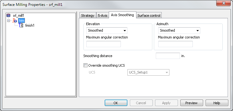

Axis Smoothing tab
You can use the Axis Smoothing tab of the Surface Milling Properties dialog to specify axis smoothing on Surface Milling toolpaths.
Note: You must select the Tool axis smoothing option on the 5-Axis tab to display the Axis Smoothing tab.
Elevation — Select how to smooth the elevation angle of the tool axis. An elevation of 90 aligns the tool with the Z axis, and an elevation of 0 means the tool is in the XY plane.
Maximum angular correction — Enter the maximum angle the smoothed axis may deviate from the initial in the elevation direction. The maximum angular correction angle is only exceeded if the unsmoothed toolpath moves by more than this value in less than the Smoothing distance. In such regions, the angle may change by more than the Maximum angular correction to give a smooth result.
Azimuth — Select how to smooth the azimuth angle of the tool axis. Azimuth is the angle between the X axis and the projection of the tool in the XY plane.
Maximum angular correction — Enter the maximum angle the smoothed axis may deviate from the initial in the azimuth direction. The maximum angular correction angle is only exceeded if the unsmoothed toolpath moves by more than this value in less than the Smoothing distance. In such regions, the angle may change by more than the Maximum angular correction to give a smooth results.
Smoothing distance — Enter the distance over which to smooth the tool axis movement. When using Stepped on Surface, or with sudden changes in direction in the original toolpath (such as a right-angled corner), you get rapid changes of orientation of the tool axis which leaves dwell marks. To prevent this, the Smoothing distance blends the change in orientation and gives a much improved surface finish.

Override smoothing UCS — Select this option to use a different UCS to the UCS used to generate the toolpath to define elevation and azimuth for smoothing.
UCS — Select the UCS to use when smoothing.
