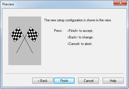

The Preview page is displayed, and a preview of the Setup(s) is displayed in green in the graphics window.
If you want to change any settings, click Back until you reach the page you want to change.
Click Cancel to close the wizard and cancel any changes.
Click Finish to accept the changes and close the Preview dialog.
