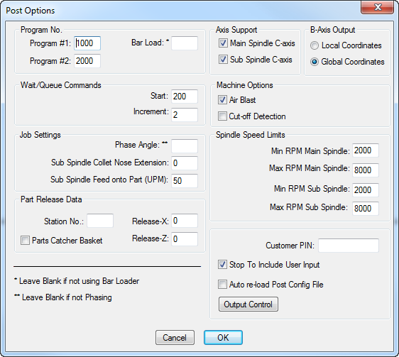

  2. Click the Generate NC Code button on the Main toolbar, then click OK on the Post Options dialog to use the default options for postprocessing.

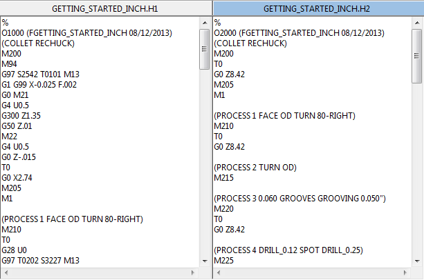

    PartMaker creates demonstration NC program code:
