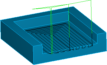

Open pocket using Pocket feature:

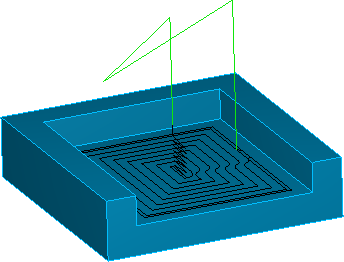

Open pocket using Side feature:
