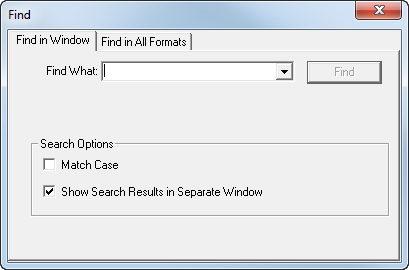

Find in Window
Use this tab to search for text in the active window.
The following settings are available:
Find What — Enter the text you want to find in the Post file. If you select text in the editor window before opening the Find dialog, the selected text is displayed in this field.
Match case — Select this option to restrict the search to finding text that matches the combination of upper- and lower-case characters used in the Find What field.
Show Search Results in Separate Window — This option enables you to output search results to the Search Results window. If this option is deselected, the matching text is highlighted in the editor window.

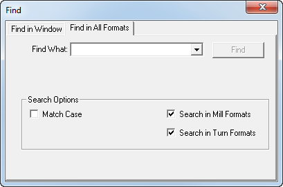

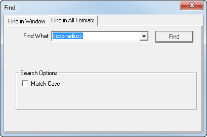

Find in All Formats
Use this option to perform a search throughout the loaded post processor file.
Search in Mill Formats — Select this option to restrict the search to the Mill Formats only. Mill Formats can be found in the Configure Mill menu.
Search in Turn Formats — Select this option to restrict the search to the Turn Formats only. Turn Formats can be found in the Configure Turn menu.

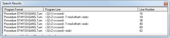

If you double-click on the entry in the Search Results dialog the corresponding window will be open and the line where matching Find What string was found will be highlighted.
Right-click the Search Results window to display the context menu. The following options are available:
View In Notepad — Use this option to see the results of search in the Notepad file named Search_Results.dat.
Close Search Results — Use this option to close the Search Results window.

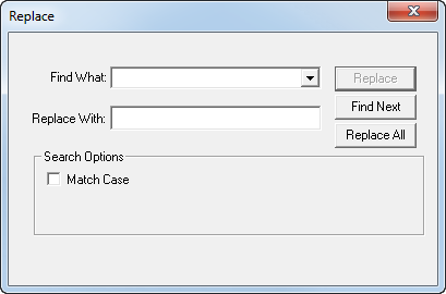

Replace
Use this menu option to display the Replace dialog.
The Replace dialog performs Search and Replace operations only in the active window.
Tip: You can also press the Ctrl+R keys to display the Replace dialog.
Find What — Enter the text you want to find in the active window.
Replace With — Enter the text with which you want to replace the text in the Find What field.
Find Next — Click this button to find the next occurrence of the text entered in Find What field.
Replace — Click this button to replace the currently selected text and find the next occurrence of the text.
Replace All — Click this button to replaces all occurrences of the text entered in the Find What field by the text entered in the Replace With field.

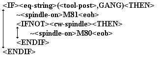

Logical Indent Text
Use this option to indent the text in all windows based on the IF/IFNOT-THEN-ENDIF conditional statements. All lines under IF/IFNOT statements are shifted to the right. An ENDIF statement closes the logical block and is aligned with the previous IF/THEN statement.
You can also click the Logical Indent Text button on the ConfigPost toolbar.
Example of Logical Indent:
Example of Nested Logical Indent:
