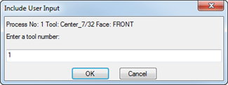

Using this construction, you will be prompted with the dialog below when generating an NC Program with a Post file including this construction:
If you enter 1 at the prompt, you will see the following in your G-code output: TOOL-IS-ONE. If you input something other than 1 at the prompt, you will see the following in your G-code output: TOOL-IS-LARGER-THAN-ONE.
