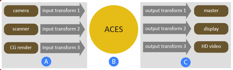

ACES in Autodesk Color Management
Autodesk Color Management presents components of the ACES framework in applications such as Maya, Flame, and Lustre.
AAutodesk Color Management applies an input transform to convert image sources to a working space, based on their specified input color spaces. Some applications also allow you to specify a custom chain of color transforms.
BACES 2065-1 is used as a connection space to convert to a suitable working space such as ACEScg, ACEScc, or ACEScct, or as a working space itself.
COutput transforms can be used to render different output types, such as the digital cinema distribution master (DCDM) or HD video (Rec. 709). Depending on the Autodesk application, the output transform that is used for display might be specified as a single option, or as separate view and display transforms.

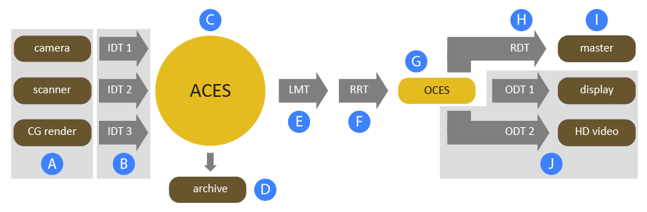

The Details of the ACES Framework
The full details of the ACES framework include additional steps, which are combined in the streamlined version presented in application interfaces. The following diagram shows how these detailed pieces fit together, using historical acronyms from the development of the standard.
AInputs from different sources may use different color spaces and encodings.
BInput Device Transforms (IDTs) convert images to ACES. IDTs may be supplied by device vendors, software vendors such as Autodesk, other third parties, and AMPAS itself. In addition, you can author your own.
The ADX to ACES transform is known as the "universal unbuild". Its inverse is the "universal build".
CThe Academy Color Encoding Specification (ACES2065-1) is a scene-linear encoding and can be used as both a connection space and working space. The reference viewing environment is outdoor daylight with a white point of D60.
DACES images can be saved for exchange or archiving in a constrained, or limited, version of the OpenEXR file format with extra metadata standardized as SMPTE ST-2065-4. The only allowable channel layouts are stereo and non-stereo RGB and RGBA.
EThe Look Modification Transform (LMT) is optional. It may be inserted before the RRT to provide an aesthetic effect, such as a shot-specific color grade that needs to be shared throughout a workflow. It is typically established by the cinematographer on set. It can be baked in to the final output, or simply used for dailies and as a reference for the final color grade.
FThe reference rendering transform (RRT) applies a transformation as a first step in preparing the images for viewing. Among other things, the RRT:
  • accommodates for the difference between outdoor and cinema viewing environments.
  • applies color adjustments associated with pleasing image reproduction.
  • corrects for normal amounts of flare in images.
There is only one RRT allowed in the ACES 1.0 standard. However, the Autodesk Color Management transform collection also includes beta versions of the RRT to support older projects that may be using them.
GThe Output Color Encoding Specification (OCES) represents the desired output colors if there were no dynamic range limitations. These values are the colors you would project in a cinema viewing environment if you had an idealized wide-gamut, high-dynamic range display device.
HThe reference device transform (RDT) converts images from OCES so that they are viewable on a SMPTE reference projector. The RDT is used as a reference for developing ODTs for other devices.
IThe output of the RDT forms the digital cinema distribution master.
JDifferent output device transforms (ODTs) are applied to prepare the images for display on other devices. As with IDTs, the ODTs may be supplied by device vendors, software vendors such as Autodesk, other third parties, and AMPAS itself.
The ACES2065-1 and ADX color encodings, and the constrained OpenEXR container specification are published in the 2065 family of SMPTE standards. Additional documents available from the Academy website describe the ACEScg, ACEScc, and ACEScct working spaces as well as other topics such as the Common LUT Format (CLF). The native color transform format of Autodesk Color Management (the CTF format) is a superset of the Common LUT Format.
