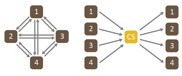

A connection space is an intermediate color space used to minimize the number of different color transforms that are needed to convert from each color space to every other one.
For example, to directly convert back and forth between 4 color spaces, you would need 12 different transformations. Adding a fifth color space would require 8 more, or 20 in total. In general, adding an Nth space requires an additional 2(N – 1) transforms, or N2 – N transforms in total.
However with a connection space, you only need 8 transformations to convert back and forth between 4 color spaces. Each additional color space requires only 2 additional transforms, or 2N transforms in total. But note that each conversion now requires two steps: the first to convert from the source space to the connection space, and the second to convert from the connection space to the target space.
