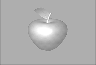

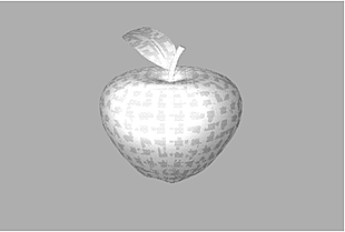

When using transparency with 3D models, you may sometimes see the back polygons, giving the model a shattered or broken look. This happens when the drawing priority of the normals is not sorted properly. Enable Sort and select an option from the Sort Order box to sort the drawing priority back to front or front to back.
