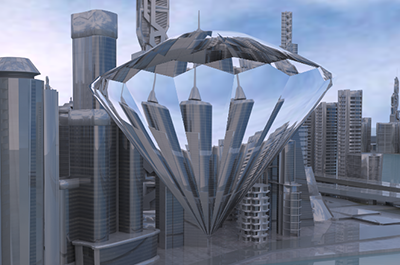

Creating Refraction
To create a glass diamond like the one above:
In Action, first make sure you have a background image.
Refraction affects whatever is behind the refracting object, so you need something in the back to see the effect.
In Action, right-click the Schematic and select Import...
From the import window, select PBS_Diamond and click Load.
In the Action schematic, double-click the Geom node named PBS_Diamond to display its menu.
In the PBS_Diamond menu, display the Geometry menu, and set Sort Box to Sort Transp.
This ensures the polygons are properly sorted in 3D space, taking transparency into account when z-sorting its polygons.
Back in the Action schematic, select the Material node named Cube and attached to PBS_Diamond.
In the Cube menu, display the Blending menu and set Transparency to 100%.
In the Refraction section, set IOR to that of the diamond,
2.418.You now have a glass cube that refracts its background. Rotate the cube to see its effect on the background.
