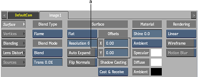

To offset a surface:
Select the surface you want to offset.
In the Surface menu, change the Surface Offset X and Surface Offset Y fields accordingly.
(a) Surface Offset fields

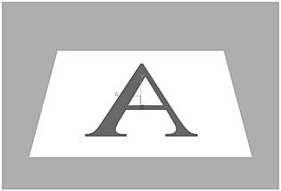

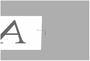

The following figure illustrates the difference between rotating a surface that has not been offset and a surface offset using the Surface Offset X field.
