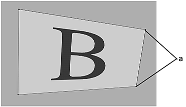

You use the vertices—or handles—on surfaces to change a surface's shape. You can move, rotate, shear, and scale a surface using the Axis menu.
(a) Vertices on a bilinear surface

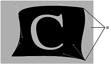

(a) Vertices and tangent handles on an extended bicubic surface
To move a handle on a bilinear or extended bicubic surface, click the handle that you want to edit. The selected handle appears in red. Use the cursor to drag the handle to its new position.
Each corner has two tangent handles. Lengthen or move the tangents to change the shape of the bicubic between corners.
