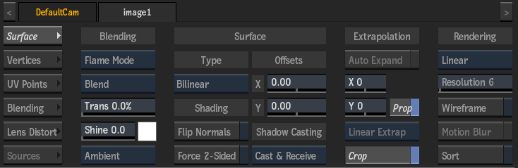

Surface Settings
The Surface tab is available at all times, and is divided into a number of sections.
Blending Section
Blend Type box
Select whether to use Flame or Photoshop blend modes.
Blend Mode box
Select how the front and matte clips or the front and back clips are combined.
Blend Premultiplication box
Select whether the blend operation is premultiplied or not. You can set this as a default preference in the Action Setup menu. Disabled if a Diffuse map is attached: use the Diffuse to set the premultiplied state.
Transparency field
Displays the transparency of the image. Enter 0 for a completely opaque image, or 100 for a completely transparent image.
Shine field
Displays the level of shine for the specular highlights (there are no specular highlights when Shine is set to 0). Editable.
Specular Highlights colour pot
Displays the colour of the surface highlights. The specular highlight is visible only if Shading is enabled in the Setup menu and if shine is greater than 0. Editable.
See Specular Highlights.
Lighting box
Select Ambient or Diffuse lighting so that the surface can reflect incidental light.
See Incidental Light Reflection.

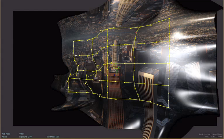

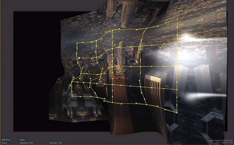

Using the extrapolation sliders, you can extrapolate the texture beyond the geometry, in X and Y. You can assign negative extrapolation values and effectively crop the texture. The extrapolation is in mirror mode, by default. You can change this by adding a Diffuse node in the Action schematic. When working with an Extended Bicubic surface, you can choose between Linear Extrapolation and Smooth Extrapolation. Smooth extrapolation produces a more organic deformation, extrapolating the deformation created by the vertices and tangents, while Linear extrapolates the surface in a straight line after the last vertices, in the direction of the tangents.
Linear extrapolation
