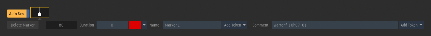

Attributes of a Marker can be modified from the Timeline ribbon, context menu, or from the Markers view.
To change the attributes of a Marker from the Timeline, do the following:
- Select the Marker to modify by either selecting it or by parking the positioner on the Marker if there is no other element selected.
- Modify the Duration, Colour, Name, or Comment from the Timeline ribbon
