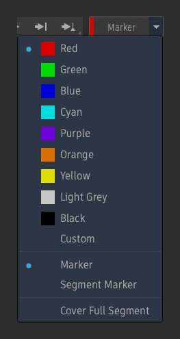

Additional Options to the Markers Button
The Marker button, available in the Player, Fullscreen Player, Source-Sequence view, Triptych Player, and Conform Player offers options to speed up the creation of Markers.
Colour Presets
Colour presets are available from the drop-down button associated to the Marker button. These presets can be set in the Colour Coding Preferences.
Note: The label associated with a colour is persisted in the Marker's metadata. When a clip is loaded on a workstation using a different colour coding legend, the colour of the Markers is adjusted to reflect the colour - label association of the new workstation.
Adding Markers or Segment Markers
By default, the Marker button adds a Marker. This can be changed to add Segment Markers by selecting Segment Marker in the drop-down button. The title on the button changes from Marker to Seg Marker to indicate what type of Marker you will be adding next.
Cover Full Length by Default
Enable Cover Full Length to have the Marker cover the entire span of a timeline segment by default or not. Disable to have the Marker have a 0 frame duration by default.
  • Markers: The duration is set to the duration of the segment on the bottom track of the primary video version.
  • Segment Markers: The duration is set to the duration of the timeline segment.
