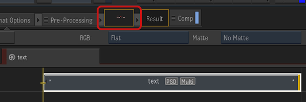

Select a Segment RGB and Matte Channels
You can now select the RGB and Matte channels of a Multi-Channel clip from a Timeline segment. Use the for the RGB and Matte channels pulldown menus, accessed by selecting the clip thumbnail in the Timeline FX ribbon.
  1. To select the RGB and Matte channels to use:
  2. Select the segment.
  3. In the Timeline FX ribbon, select the segment thumbnail.
  4. Select the RGB and Matte channels.
RGB Selection menu options:
  • Channel name: Displays this channel in the Player.
  • Flat: Flattens the channels.
Matte Selection menu options:
  • Matte layer name: Displays this matte in the Player.
  • Follow RGB: Automatically displays the matte associated to the currently selected RGB channel. This is the default option.
  • No Matte: Disables the matte.
Note: Similar to settings from Format Options and Pre-Processing settings, the Front and Matte selections are applied to all instances of the selected segment. To isolate the modification to the current segment only, select Context Menu Duplicate Source before editing the channels.

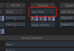

Display the OutMatte in the Player
To display the OutMatte of the current frame in the Player:
  1. Do one of the following:
    • In the Player's Viewing Settings panel (Alt+1), select Channels Show RGB Show Matte.
    • Use the Toggle RGB/Matte Channels keyboard shortcut: Shift+M
Note: The Matte is the output of the clip positioner, not the timeline segment. In some situations, especially in vertical composites, the displayed matte might not be the matte you expected.
