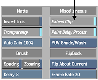

To add frames to the end of the clip:
  1. Click Setup.
  2. Enable Extend Clip.
  3. Click Next Frame.
    A frame is added. You can continue to add frames in the same manner with Extend Clip enabled.
To maintain the length of the original clip, disable Extend Clip. No frames are added to the clip when you click Next Frame.
