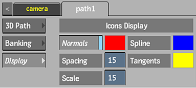

You can change spline display properties in the Display tab. For example, you can change the colour of tangents on the splines you draw. This is useful to better contrast the spline’s tangents from the clip so that they are easier to work with.
Normals button
Enable to display normals along the 3D path.
Normals colour pot
Displays the normals colour. Editable.
Spacing field
Displays the space between the displayed normals, in pixels. Also used to calculate the position of the object on the path. A lower value may result in better positioning and smoother movement of the object, but rendering may be slower. Editable.
Scale field
Displays the scale of the displayed normals, in pixels. Editable.
Spline colour pot
Displays the colour for the display of splines. Editable.
Tangents colour pot
Displays the colour for the display of tangents. Editable.
