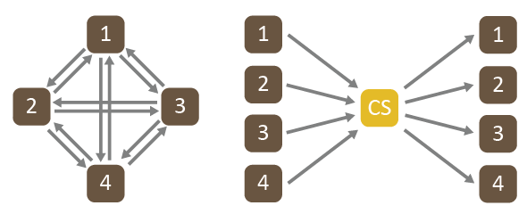

A connection space is an intermediate colour space used to minimize the number of different colour transforms that are needed to convert from each colour space to every other one.
For example, to directly convert back and forth between four colour spaces, you would need twelve different transformations. Adding a fifth colour space would require eight more, or twenty in total. In general, adding an Nth space requires an additional 2(N – 1) transforms, or N^2 – N transforms in total.
However with a connection space, you only need eight transformations to convert back and forth between four colour spaces. Each additional colour space requires only two additional transforms, or 2N transforms in total. But note that each conversion now requires two steps: the first to convert from the source space to the connection space, and the second to convert from the connection space to the target space.
