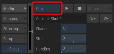

  2. From the Media Source drop-down, select whether you want to analyse the current audio clip (Clip) or import an audio clip (File).
    If there is more than one audio clip associated with your choice (for example, Front, Back, or Matte), you can choose which one to use in the Name drop-down. If only one audio clip is available, the name of the clip appears in a locked field.
    If you select File, click Import to open the Import Audio browser, and select an audio file to import.

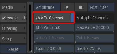

  5. From the Mapping submenu, enable Link To Channel.

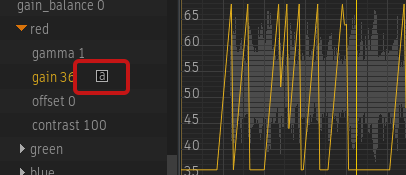

    The letter ‘a’ appears next to the channel in the Channel hierarchy, indicating that this channel is linked to the audio.
  6. Use the settings in the Mapping submenu to determine how the audio track is mapped to the selected channel. Keyframes are adjusted automatically as changes are made to the settings.
