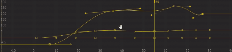

To pan the Animation Channel canvas:
  • Select Tools drop-down Pan and drag the Animation Editor canvas.
  • Space + drag the Animation Editor canvas.
Whenever you select a channel, the canvas automatically centres on it.
To stop automatic channel framing:
  1. Click the Frame Canvas menu.
  2. Deselect Automatic Framing.
To centre the canvas on a selection:
  1. Select
To centre the Animation editor on your work, click one of the following:
  • Frame: to centre the display on the currently selected channel.
  • Frame All: to centre the display on all the animation channels that have at least one keyframe set on them.
    Note: These buttons are located at the bottom-left corner of the Animation editor.
To pan the Animation editor:
  1. From the Tools drop-down, select Pan.
  2. Click and drag the cursor to pan the view.
To zoom the Animation editor:
  1. From the Tools drop-down, select Rect Zoom.
  2. Click and drag a rectangle on the area you want zoom.
Note: You can zoom x and y independently. Use the Zoom command from the Tools drop-down. Click and drag up or down to zoom the y axis. Click and drag left or right to zoom the x axis.
