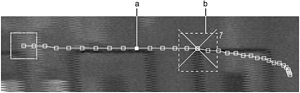

  1. Zoom in on the image until you can see the points clearly and select the point you want to lock on the tracking path. Keyframes must be locked one at a time. The tracking path becomes white when you click it, and the frame that corresponds to the keyframe appears in the image window. If the tracking path does not appear in the image window, enable Path in the Setup menu.
    (a) The inside of locked keyframes are filled (b) The tracker box appears when you select a keyframe
  2. Click Lock Key.
To unlock a keyframe, select it and click Unlock Key. The Lock Key button becomes Unlock Key when a locked frame is selected.
