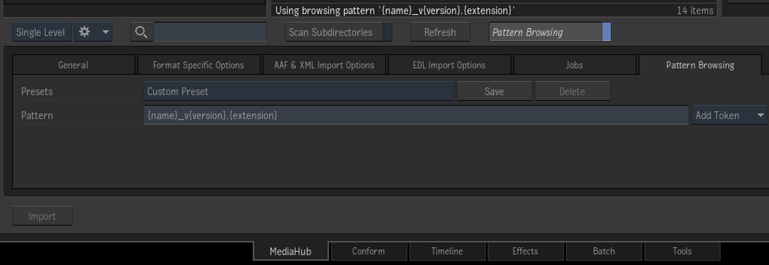

To Browse Files Using Patterns
By accessing the Pattern Browsing tab in MediaHub, you can browse content using patterns similar to the ones used to create patterned Open Clips.
To use pattern browsing:
Enable MediaHub
Pattern Browsing.
The message Using browsing pattern confirms that pattern browsing is used. It also displays the pattern used to filter contents in MediaHub.
By using Pattern Browsing, you can import a complex file structure as multi-channel/multi-version like you would when building Open Clip, but without having to manually build Open Clips. These clips are then automatically updated when new versions matching the pattern are available on the file system.
Tokens can be used to match file names or folders. You can use pre-defined tokens, or your own custom tokens.
Clips matching the defined pattern are seen with V or Multi icons, based on the pattern. Also, the MediaHub status bar displays the current pattern used to browse when Pattern Browsing is enabled. That way, you know MediaHub uses Pattern Browsing to display content.
From the Browsing Pattern tab, you can also create and manage shared presets. As with any MediaHub setting, these options are saved with the project.
When new content matching the pattern is added to the file system, it is possible to update clips in Flame using the Source Version Update Source from the context menu in Media Library, Batch Group or Timeline.
