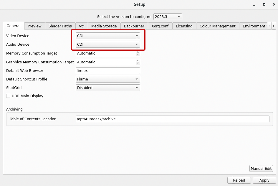

  1. Open the Flame Setup application
  2. In the General tab, set Video Device and Audio Device to CDI.
    Flame setup - general

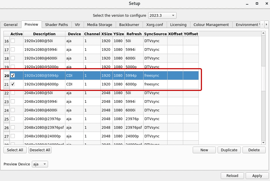

  3. Open the Preview tab and select the CDI preview timings you need.
    Flame setup - preview

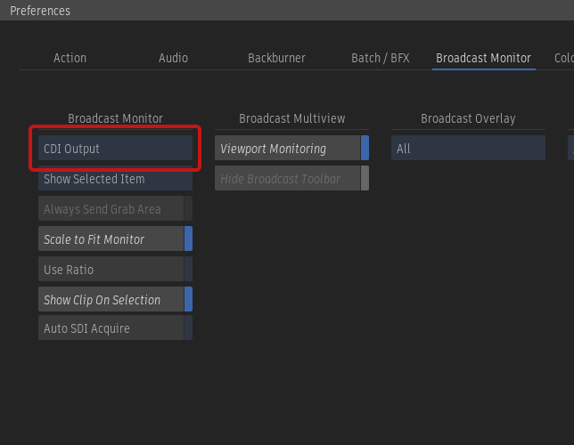

  5. Open Flame menu Preferences Project Video Monitoring.
  6. Set Video Preview Device to CDI.
    Flame preferences - CDI Output

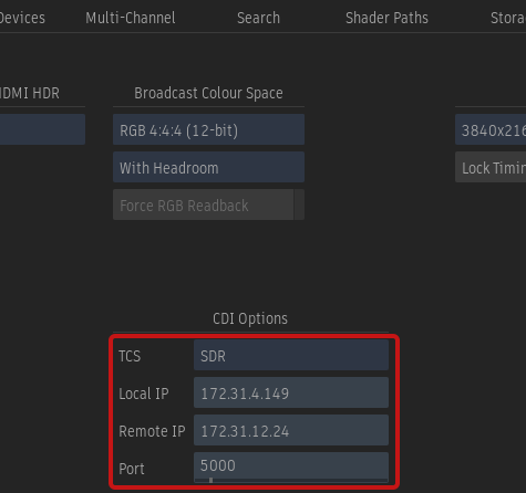

  7. In the CDI Options section, set TCS, Local IP, Remote IP, and Port.
    Flame preferences - CDI Options
    • TCS (Transfer Characteristic System): Set the type of transfer function used for the video preview signal. Important: This only sets CDI metadata; you are still responsible for configuring Flame itself to the correct HDR or SDR mode.
    • Local IP: Enter the private IP of your local machine (it can be found in the AWS Console page, under section EC2).
    • Remote IP: Enter the IP of the remote CDI receiver.
    • Port: Enter the port to use for the remote CDI receiver.
